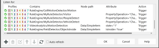

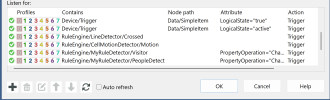

Attempting to use Camera Build-in AI IVS for object detection over BI Motion Sensor (coz tree shadow generates too many false trigger). I successfully setup Camera Tripwire IVS and BlueIris is able to receive the trigger from the PTZ camera, and as a result BI sends me a Pushover notification (Camera Tripwire IVS translate to Blue Iris ONVIF event contains: RuleEngine/LineDetector/Crossed in BI).
For Abandoned Object IVS (use for package and food delivery detection), I setup via camera WebUI and confirm that object is being detected by the camera after 10s left inside the detection zone (indicates by Red blinking of detection zone outline). However, BlueIris/Alert has no response to the Abandoned Object IVS (I will call it AO-IVS moving forward). My question is: how do I know if camera has sent ONVIF AO-IVS trigger to camera? Camera Log? Blue-Iris Trigger Log? (I cannot see any AO-IVS relating trigger in BI activity log).
My camera has the latest available Firmware; BI is Ver 5.9.9.52 (5/13/2025);
Please see next post for BI camera settings screenshots.
