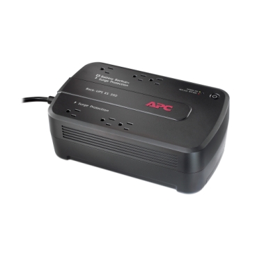

As suggested by several people, I am going to get a UPS for my replacement NVR.
APC seems to come highly recommended to value vs quality.
Does anyone know what the differences are between their Back-UPS, Back-UPS Pro & Easy UPS?
Are there any specific features I should be looking for?
Look at the full load run time for the UPS you are looking at and compare to NVR load. You will notice that most will only give you a few minutes run time.
Most of the time you only need it for a quick power blink. I am using 2 large UPS. (1) Tripp Lite SMART 2500XLHG with extra Battery Pack with load on it gives me 3 - 4 hours run time.
(2) SMART1500RMXL2UA with extra Battery Pack also gives me 5 + hrs run time with the load I have on it. Also have some smaller ones used on some switches.
