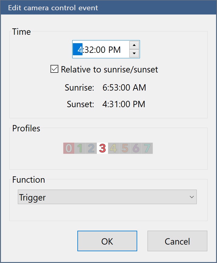

It worked below are the steps
Step 1 create an sunrise/sunset override schedule.
Step 2 create a trigger event 1 minute after sunrise
Step 3 create a trigger event 1 minute after sunset

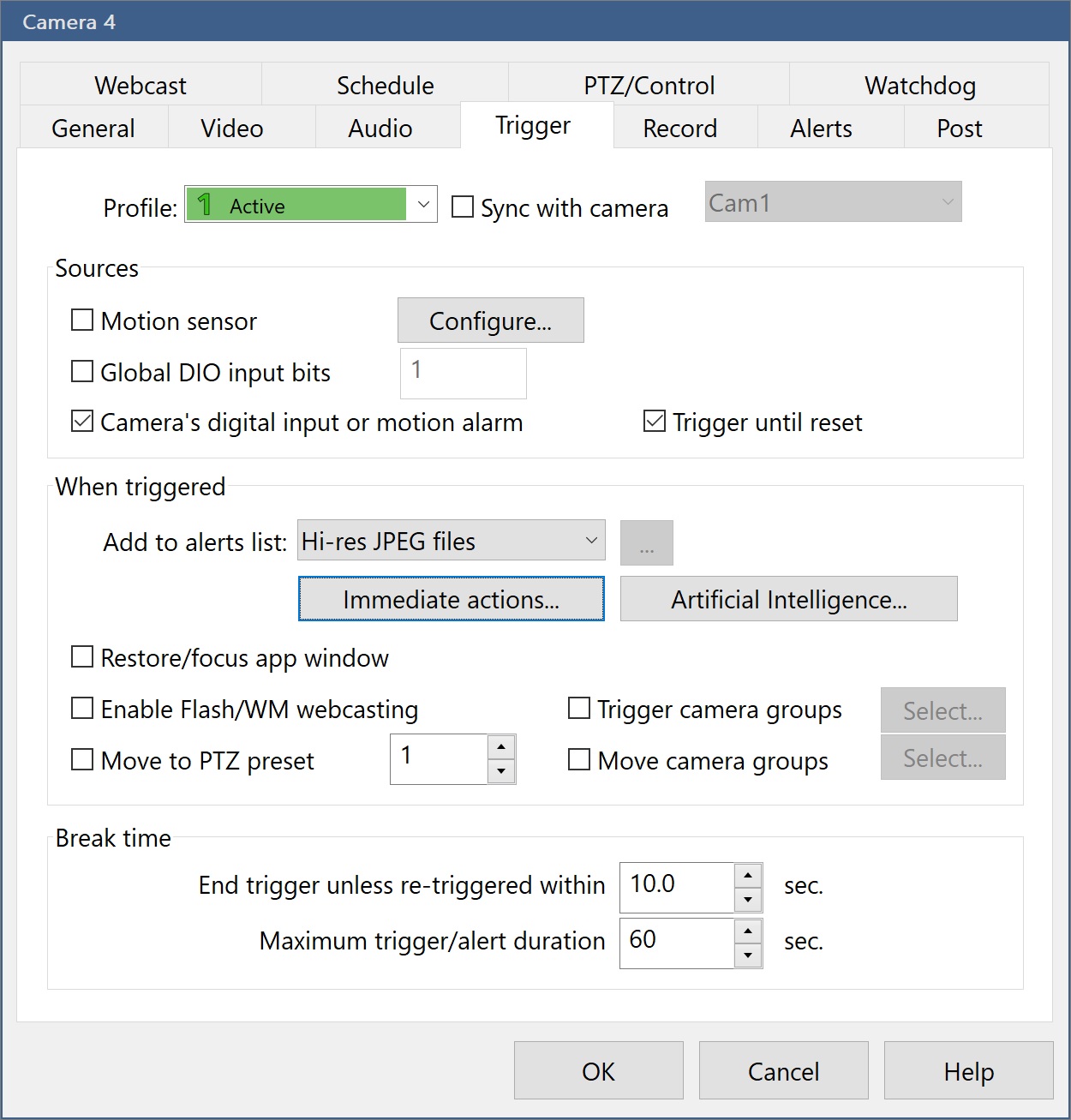

Step 4 create two trigger immediate actions

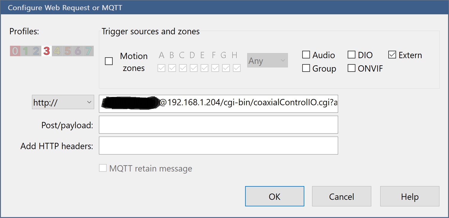

Step 5 create sunrise Web Request
Step 6 create sunset Web Request

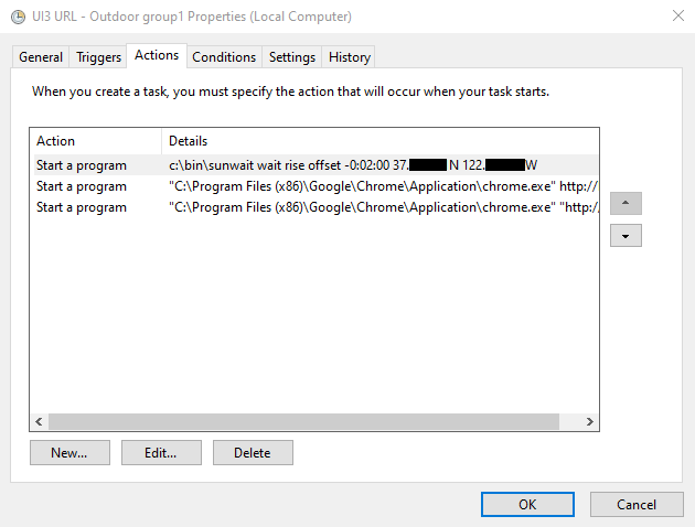

Here’s another interesting option… one that uses Task Scheduler instead of triggering a camera via its events schedule.
Simply execute sunwait.exe as the first Action in a daily scheduled Task to delay execution of the remaining Actions (your urls) until the desired sun time. Click <here> to learn more.
An example ‘sunrise’ task follows… the task executes at 5am, executes sunwait.exe, then waits until sunrise at my location to execute its remaining actions. In this case two urls are executed from Chrome in the foreground - you’ll see new tabs opened In the browser.
Where Action #1 is...
'Program' = c:\bin\sunwait
'Add argments' = wait rise offset -0:02:00 36.xxxxxxN 109.xxxxxxW
and Action #2 is...
'Program' = "C:\Program Files (x86)\Google\Chrome\Application\chrome.exe"
'Add argments' = “your url”
and Action #3 is...
'Add argments' = "another url"
