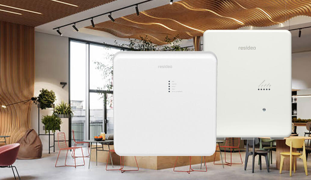

I talked to a salesperson at Alarm Grid to ask what I need to add cellular monitoring to my system. Due to the age and limitations the current control panel (Napco GEM-P3200), he suggested a Honeywell Vista 20P with a 6160 keypad ($155.99). The communicator would be a Honeywell LTEM-PA ($157.99).
One thing the salesperson said that compromised my confidence: He said "...if the cellular signal outside your home is not good enough, an antenna isn't going to help you - you need a cellular amplifier." Huh?
Questions:
1. Are the two items mentioned appropriate choices given that I want to add cameras and remote home automation in the future?
2. I called Alarm Grid because others on this forum seemed to be pleased with their service. What other companies should I consider if I don't want to self-monitor?
Questions:

Are you saying that the Honeywell LTEM-PA doesn't have a good way to connect to an antenna?
Old Timer
Jul 20, 2018
1,352
2,945
I'm ok
Yes, I am. I spent 20 years in audio/video systems design and installation, including TV, FM, and satellite antenna work.
The 20P is easy to install, little harder to program, but doable if you take your time.
I went and looked, looks like internal antennas.
If it had an external antenna connector, you could run low loss coax, and an outside antenna.

-- Honeywell Vista 20P with a 6160 keypad - $155.99
-- Honeywell LTEM-PA - $157.99
-- Cellular Monitoring - $35, $45 for video
